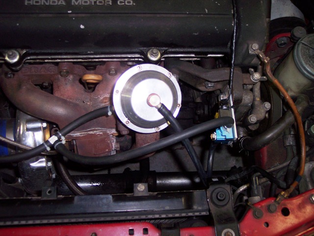

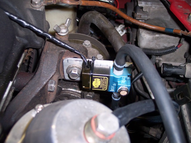

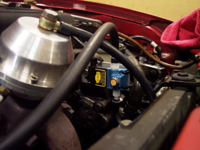

Here some pic of the eCtune solenoid and it's vac connection to give some folk an ideal.
