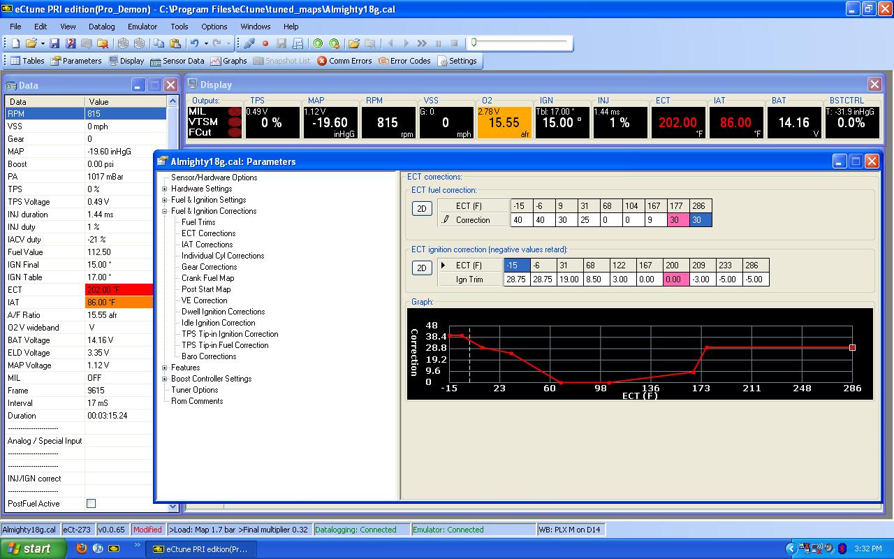

Was messing around with my tune I went to adjust ECT corrections and notice my A/F ratio wouldn't change no matter what value I put in. Take a look
ECT Correction.JPG (199.02 KiB) Viewed 21869 times
Check the ECT.f and see if it shows it + or - fuel..

do you see the correction there?

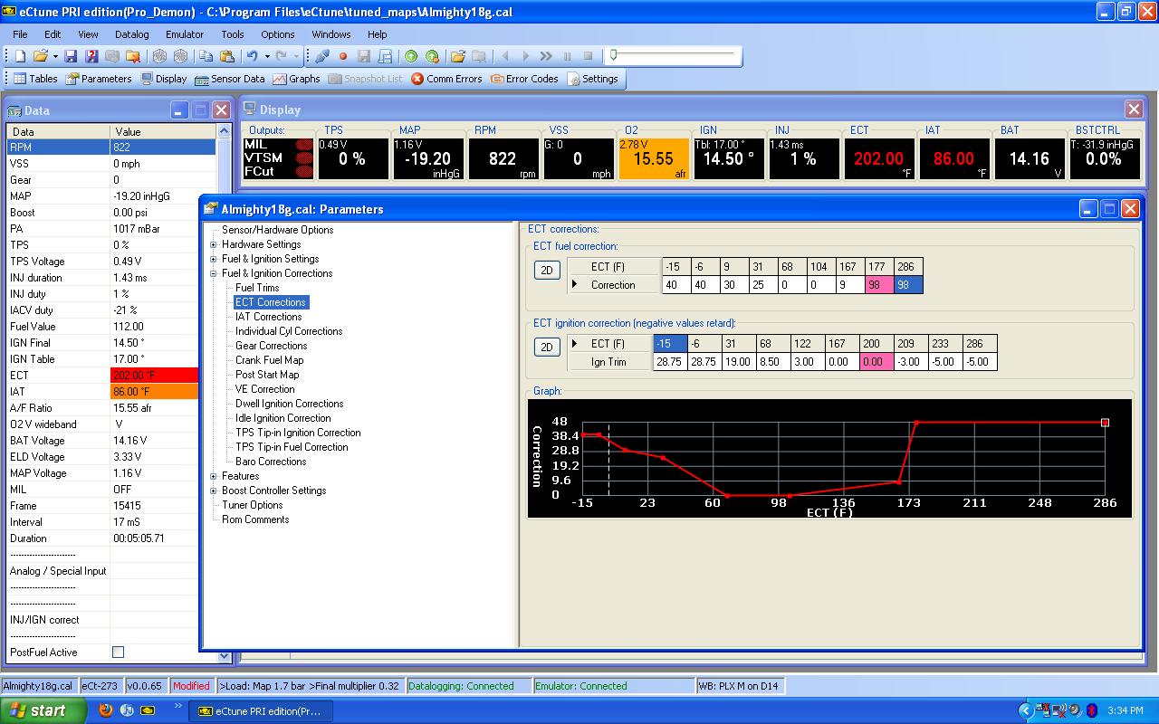

screenshot
screenshot

Thats kind of strange cause when you change the settings in the colder part of the table your cold start will react as you would expect.
calvin wrote:do you see the correction there?
Isn't that my point?
The corrections work fine. The issues is that stock honda code only updates ECT values every couple minutes it seems. so you won't see an instant change. If you keyy of then back on your values will update. I talked to calvin today about trying to shorten the update timer for ECT values so you guys will stop freakin out..
