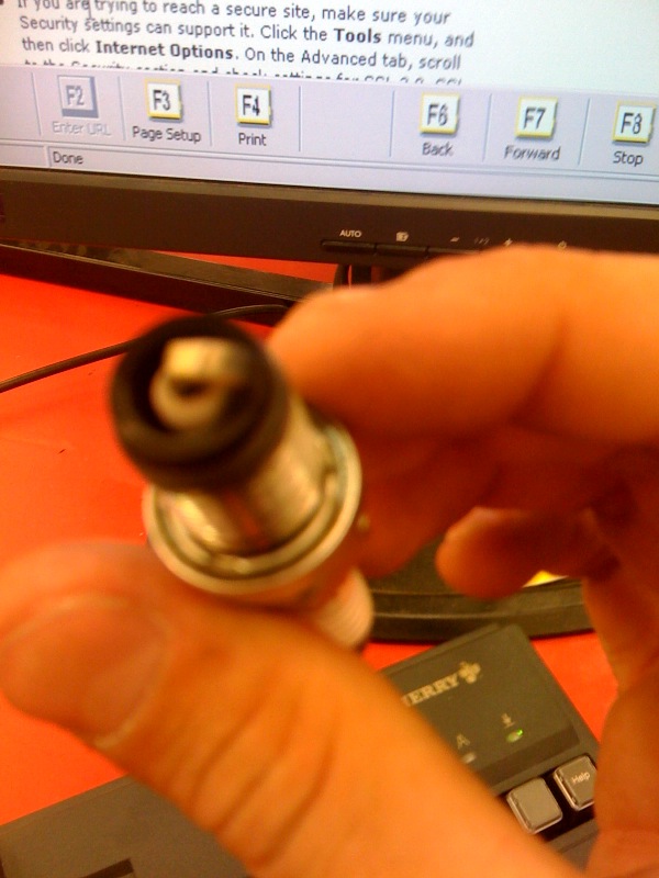

ok, so i do need to add some more timing, but did what you said, gapped em to 21 or so and still does it, just as bad. ive enclosed a pic of one of the plugs. its super blurry but you can see where the timing mark is. please any ideas would be fantastic
no.. not .021.. .016 .. Theres a big difference. And make sure when you gap it, you gap it good. You'll have to use a feeler gauge to gap that small, and make sure its flat between the ground strap and electrode and theres no play in it. I've seen many people gap plug to say .020 and they are really at like .028 cause they didn't hold the gapping medium straight lol. Post up your map and I'll take a look at it.

should be up there, last of the three files i uploaded after the logs. ok my gapper went down to 20 so i hit 21 and went with it. ill dig out my feelers after work tonight and try it in a couple days (supposed to rain next two days here)
