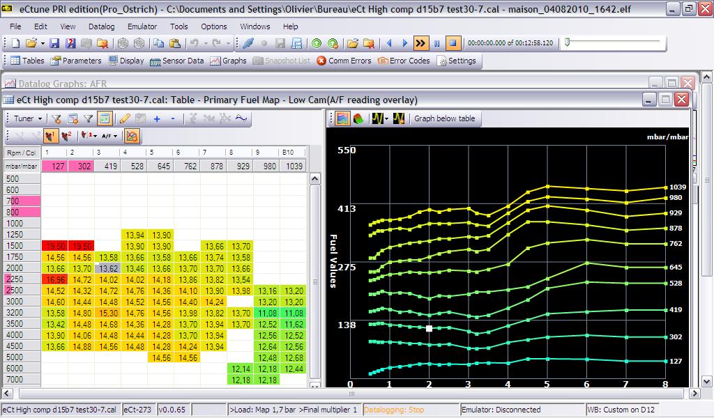

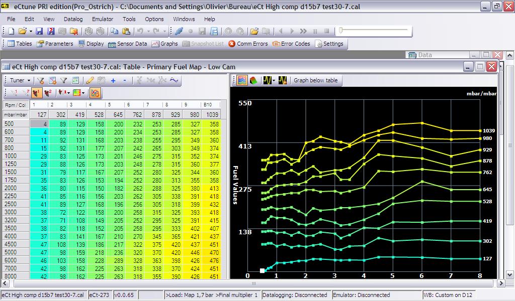

My afr value are great but my graph is not smooth. I want to know how eCtune calculate the fuel value with the selected cell and the three around of it to change the good value and smoothing my graph. thanks for helping me

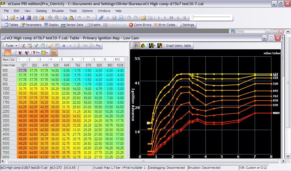

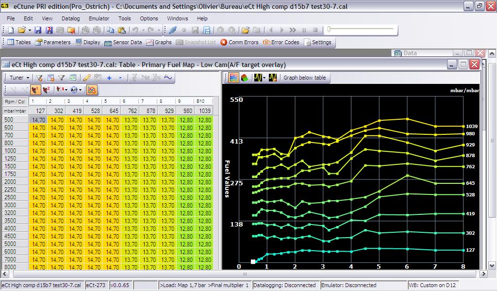

My graph look like this setup n/a D15B7 Walbro 255 at 60PSI P29 pistons stock cam with 2°retard
af target.JPG (167.16 KiB) Viewed 13417 times
low igni.JPG (164.99 KiB) Viewed 13417 times

To my knowledge, the fuel/ignition values are taken from the cells and interpolated. This is all part of the standard Honda code on which eCtune (and others) are based. However, sometimes you´ll find that the engine just \"wants\" some odd twists to the fuel curve. Often I have tried to even everything out, only to find that it´s not working... This can be especially true for some engines with wild cams or some intake systems. Remember this is all based off a MAP sensor and not actual air flow. So which ever oddities in the engine causing different air flow for various rpm/MAP values, will be shown in the maps if you take the time to tune everything spot-on perfect. As long as you dont have fuel curves crossing, dont worry too much about it :) Especially if the AFR is good and the driveability is nice. /Allan

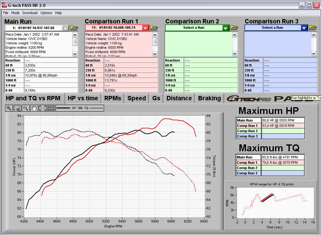

My driveability is nice especially since i have retarded my stock cam to 2° retard. The change was impressive from low to high rpm. there is my g-tech result. I'd do more testing with cam gear in the next days Thanks a lot Allan you really helped me
The black curve with stock cam gear The red curve with aem cam gear and 2° retard
gtech 2° retard aac.JPG (160.1 KiB) Viewed 13403 times
You need to make the map symmetrical. Spend time manually smoothing your map. Most of the time when its calling for a dip or a spike in the lines, look above or below it, chances are if its telling you to pull a bunch of fuel, a cell close by has to much. Don't try to hit exact target air fuels, just a safe range throughout the column. Give and take, do whatever it takes to create a smooth map. The cars drive ability will reflect it.

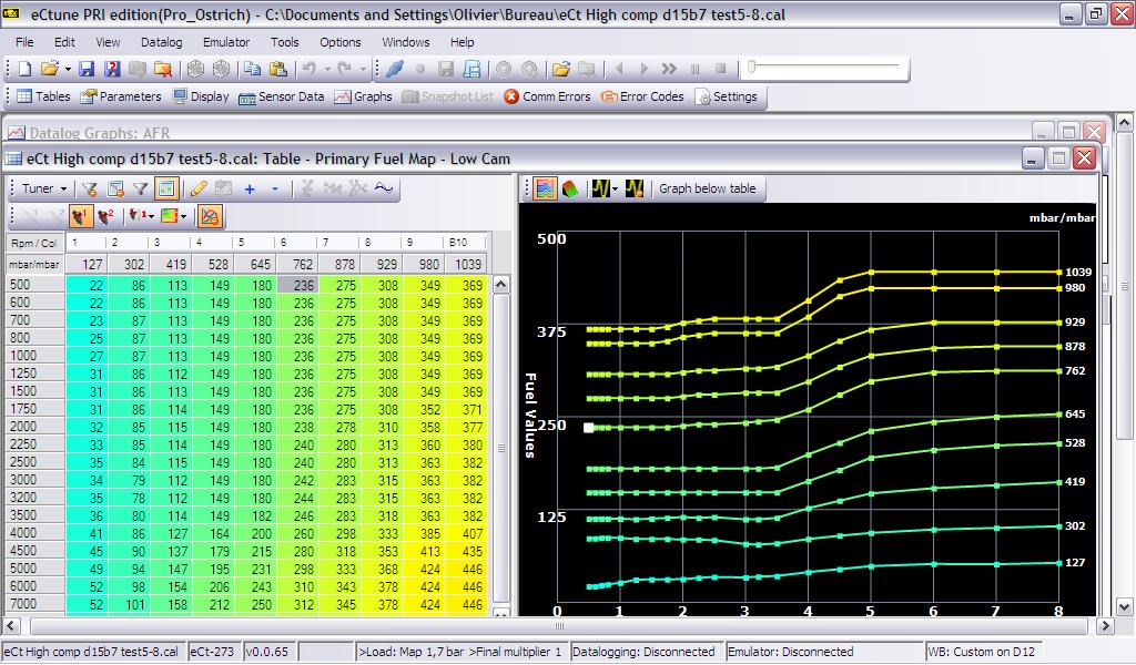

AWESOME thank to you Dan, my graph look better and the afr stay to good value
Here is my last update
new graph.JPG (151.48 KiB) Viewed 13374 times
1st step
1st step
1st step.JPG (147.98 KiB) Viewed 13374 times

That's a good result. It's mad how much smoother that looks just by \"tweeking\" it a little bit. If you don't mind me asking, how much time did you spend correcting it? Paul.

haha, glad to see you getting it, amazing isn't it. I see quite a few spots still left you can keep ironing out. Your doing an excellent job however. The symmetrical trick is one of the best I've learned, its an easy way to tell who knows what on here. Rough map, rough and 'notchy' feel. Stay away from tuners that don't understand this. Also if you ever can not get rid of a wild fuel curve that it keeps demanding.. Play with your injector offset, it will disappear..
