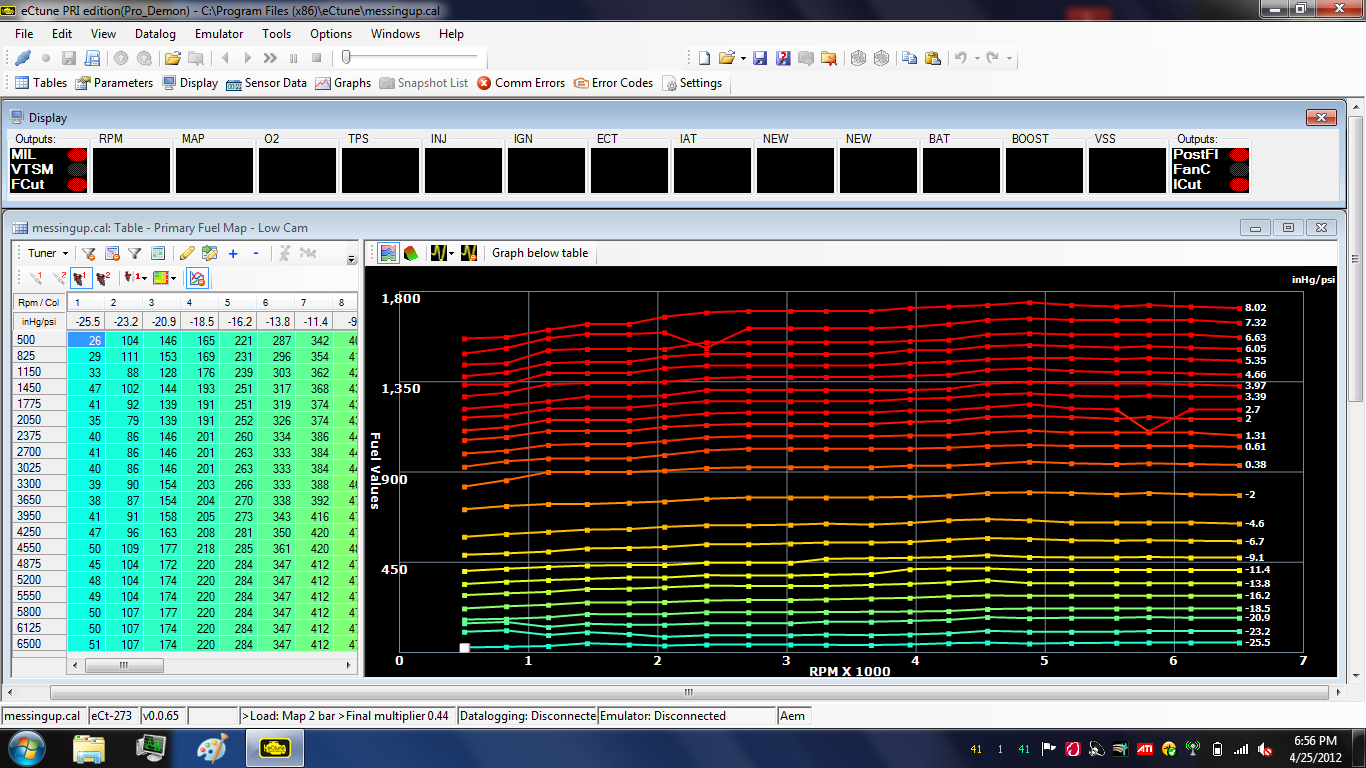

I am using the demon. I have heard that Honda ecu's are noisy. What I don't understand is when I have a issue I rewrite a new file and all is well. If it was noise I don't think that a recreation of a tune would change anything. Also what is ectune checking for when verifying a rom. Sometimes when I perform this action the rom comes back UNverified??
My guess is somehow the demons memory bits get flipped... Wether it be interference, or some other odd reaction. Make a thin grounded tin box to encapsulate the demon... If your a fabricator... That should all but eliminate the problem... But who knows, maybe your demon is faulty? There are a few possibilities, gotta narrow it down.

Here is a screen shot of the rom downloaded from ecu today. This is a common occurrence no matter what I do. See the odd ball cells? Seems to always do this in the same manner and the same cells. Bad Demon? I just purchased it with the ecu. I hope not!
