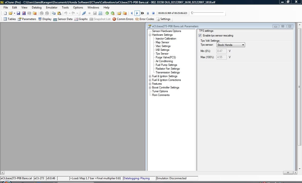

Another problem: I just finished a logging session, and when I pulled over, I recalibrated my TPS, then unplugged. When I walked over and opened my laptop back up after getting inside, I saved the datalog, then my maps, display, and logger window are gone, I can pull up the parameters window, but none of the others. They seem as if they are hidden. Here is a screenshot: http://i26.photobucket.com/albums/c115/ ... CTune6.jpg I tried closing ectune, etc, but to no avail. I can see the program refresh as it does when you normally hit the buttons, but nothing. I will try hooking back up again to see if it works. ***UPDATE***: After a reboot, I loaded ECTune, and it had a scroll bar; it turns out my window was about 3 miles to the right, and when I scrolled all the way back to the left, the windows were there; but all stacked on top of each other. When I took the screenshot, it was after attempting to close and reload ECTune. When I reloaded ECTune, the window had the scroll bars that you can see in the screenshot. When it first happened, before closing ECTune, there were no scroll bars. I could not recreate this bug.

where your windows not minized to the bottom, scroll down and maximize them again?JaredKaragen wrote:Another problem: I just finished a logging session, and when I pulled over, I recalibrated my TPS, then unplugged. When I walked over and opened my laptop back up after getting inside, I saved the datalog, then my maps, display, and logger window are gone, I can pull up the parameters window, but none of the others. They seem as if they are hidden. Here is a screenshot: http://i26.photobucket.com/albums/c115/ ... CTune6.jpg I tried closing ectune, etc, but to no avail. I can see the program refresh as it does when you normally hit the buttons, but nothing. I will try hooking back up again to see if it works. ***UPDATE***: After a reboot, I loaded ECTune, and it had a scroll bar; it turns out my window was about 3 miles to the right, and when I scrolled all the way back to the left, the windows were there; but all stacked on top of each other. When I took the screenshot, it was after attempting to close and reload ECTune. When I reloaded ECTune, the window had the scroll bars that you can see in the screenshot. When it first happened, before closing ECTune, there were no scroll bars. I could not recreate this bug.

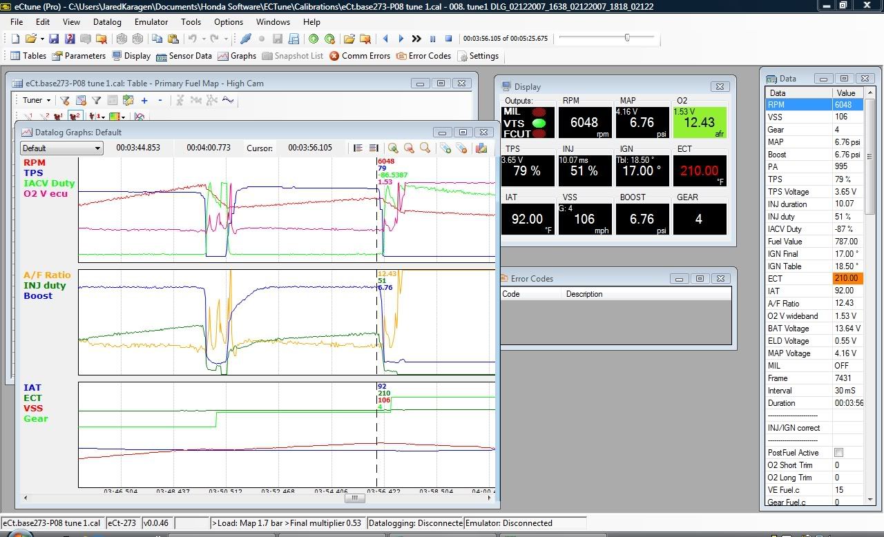

ok, After trying a different things, I was able to get my JAW Vout profile into ECTune, and did a few logging sessions and adjustments. The datalogs look much better (alot less crazy AFR readout) and am getting results; For some reason ECTune has me basemapped at alot less timing than my CROME map had; once I get some good AFR's all around, I will tackle this one; cause it should have a lil more. Anyways; Good progress is the best progress!
