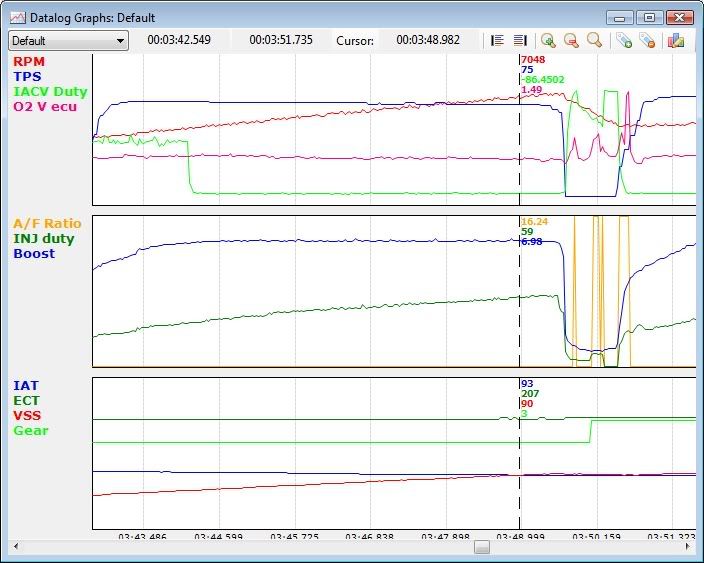

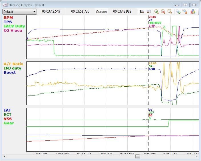

yep, I tried the blank bug, and it was fixed; sorry for the hasty reply; I meant to specify the blank bug was gone and the JAW profile works good, but the narrowband bug is still there, here are some screenshots. You can see in the datalog graphs what it should look like, vs what it looks like with the profile changed without selecting \"custom\" before changing the slope values: Image With custom slope added without first selecting \"Custom\" Now, nothing loaded or closed or changed in the program besides selecting the JAW profile and saving the setting: Image With the JAW profile selected Look at the AFR line, it shows what I am seeing.
as soon as you change something in the wideband convertion it goes to custom. I don't understand the bug. Try to be a bit clearer
yes, it automatically chooses custom, btu the way the display shows the AFR readout is whacked and bound to the profile the last selected wideband had. In the case of a narrowband sensor, when you select it it counces between 3 readings; locking onto and displaying the closest reading of the 3... exact steps: load a datalog. settings menw->Wideband (using the wideband input through the o2 input wire) Choose narrowband WBo2, and save the settings, now, playback the recording; it locks between the 3 values (you might need to play with the offset to get 14.7 to line up with your log, but shouldn't have to) high, med and low, 10afr, 14.7afr, etc. It will playback the wideband AFR graph just as if a narrowband was hooked up. If you go into the settings -> wideband again, don't do anything but delete the last 2 values in the table, and put in this linear slope: 1.00=10.00 2.87=28.70 click on save and continue playback, it should still be displaying the AFR in that non-linear fashion, just like the narrowband......
