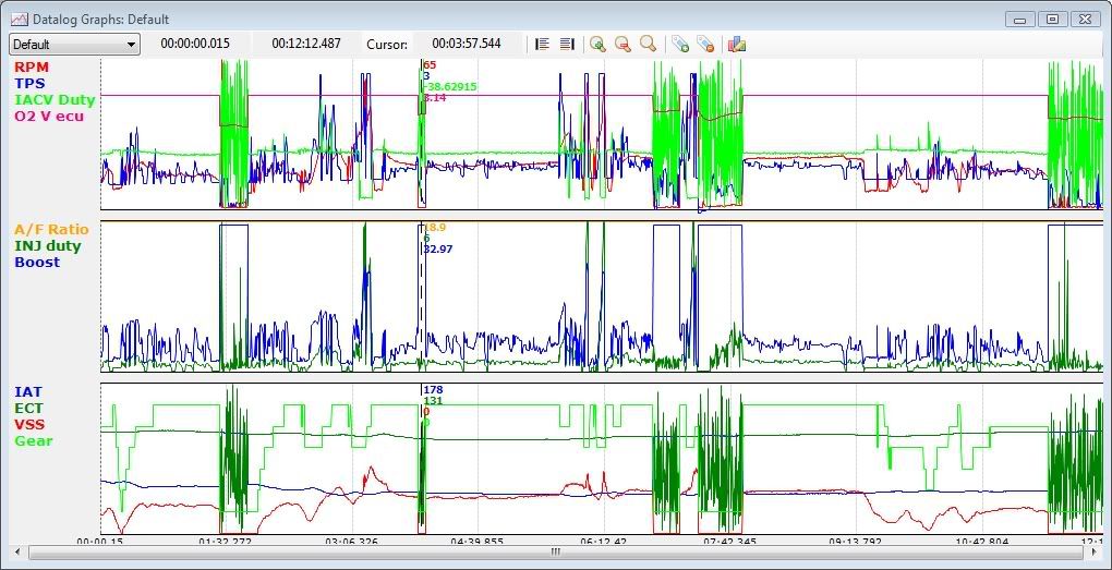

UPDATE: Problem Fixed. Calvin and I have came to the conclusion that the nokia cable with a dual core processor will cause the computer to recieve trash information. I have tried every driver that I could find with no success. I purchased the HULOG and it has fixed everything. I am having a problem with data logging. It will connect and work correctly until it decides to go crazy. There is nothing I can see that I am doing to cause this because it is doing it randomly. I have my .elf and .cal that shows what I am seeing. If you need the cal I can send it to whom ask for it as long as your registered with ectune.(I don't know if it is ok to post cal's on this forum yet? Please let me know.) you can watch it if you want. Everything just goes crazy with my sensor data. To make it start acting right I just have to unplug my nokia cable from the ecu and then plug it in real quick. The car does not run different when it does this and my cel on the dash does not come on even though data logging and the mil light on ectune says it should be. Thanks again for your guys help!

you port latency is to low? moates FDTI device?(i had on 1 and problems, garbage) or nokia cable. I had serve problems with nokia and dual core processor. just read you are using a nokia cable?
Did you also notice that when your ect, batt, and rpm drop your inputs and outputs go through the roof? It looks like a christmas tree. Since you said the car still runs fine while this behavior is happening I'd kind of look towards the cable being messed up ie; loose contact maybe just taking a shot in the dark.

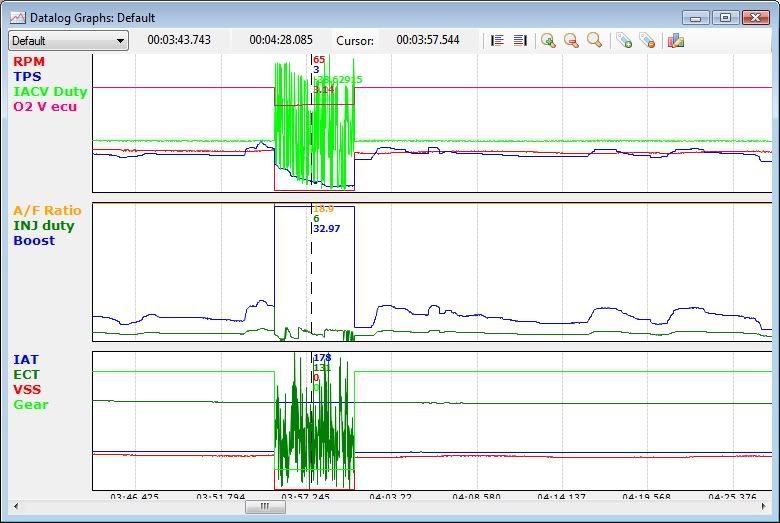

Ok, Im looking at it now; This is kinda odd; all the readings go off the charts for some reason... but come back after a few seconds.... how bumpy was the road you were on? It appears that you are on a highway; holding around 70mph 'ish.... Are you boosted? and I see the lack of the o2 data >=D Maybe this is the view of whats going on when the nokia cable \"isn't working\" for most users... *edit* ok, just re-read the above posts.... I swaer, I spent $35 on a HULog, and all my nokia heartaches went away in a microsecond! Heres pics for those who don't wanna load it all:

Ok you see where it is going from bad data to good data is when I am unplugging and plugging the cord back in at the ecu. I am buying the hulog first thing tomorrow morning. This is the only problem I am experiencing and it is being caused by my equipment, not ectune. I did try your invert question and it worked for me, so maybe just your computer acting crazy. Thanks again
