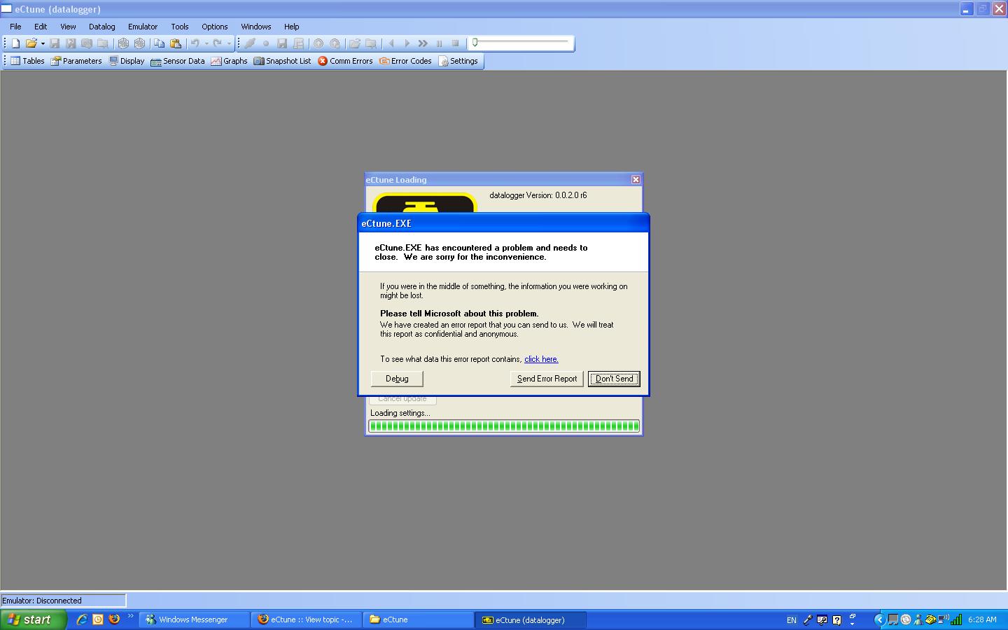

I'm already emailing Calvin on this but don't have a solution to the problem yet. I finally got upgraded laptop.. new Dell Precision M90. old laptop is traded in. I tried installing the installer version for 0.0.2.o r6 but can't get into Ectune long enough to register it.. it crashes immediately after the splash screen shows. If I try to copy my old license.xml file into Ectune, it opens but gives me error 004h telling me to email ectune.. when I click OK to that, it closes immediately. Is there something I did wrong? Or something I should do that will allow me to register and continue? Maybe you should make a Register applet separate from the main program? Or when the program opens with no valid license, it require you to register rather than crash or simply close..

unfortunately, reinstall on this laptop isn't an option. It's work laptop. I have all Windows Updates installed... .net 1.0, 1.1, 2.0, 3.0, etc.. everything updated.
main app at crash
main app at crash

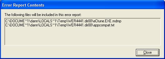

error details
error details

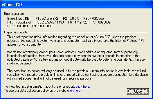

more details
more details

I did take the license out. With the old license in, I only get an ECTune error (004h) and the application closes normally. With no license, I get the above crash. Aside from the applications my MIS dept installed before I got it, the laptop was fresh out of the box from Dell. They are the same applications (mostly) that I had on my previous laptop, with the exception of Office 2007. Getting all the work applications reinstalled is a 4 hour babysitting job - they aren't going to let me wipe the drive very easily..
