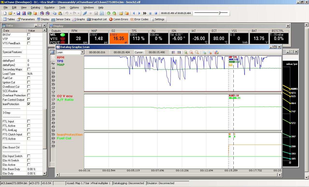

i see something else. Can u confirm that lean protection flag in datagrid goes on when lean protect is on? I don't see it on in the log. Test with idle let leanProtection activate check the lean protect flag/checkbox in data grid while making a log file. Please let me know
i just did a bench test everything seems fine and i didn't change any code and lean protect flag is goes on... I'm afraid something else happens by you..
lean protect checkbox on/graph on
bench2.elf
Before lean protect MAP&gt;1PSI AFR =&gt; 3.2v lean protect ON encluding flag in data grid
(49.44 KiB) Downloaded 1038 times
benchTest.cal
see lean protect settings... AFR 3.2v Map 1 psi
(8.17 KiB) Downloaded 1066 times
