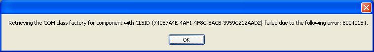

I did \"Force Update\" from the previous version on my Desktop PC. It completed successfully. Then I went to open it. I got message saying I didn't have .net 2.0 or 3.5 I did have 2.0 and 3.0 but not 3.5. I searched Microsoft for 3.5 and installed it. Now I get past that error message and get this one: (see attached image)
Com Class factory?
Com Class factory?

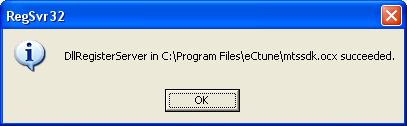

It continued to load and followed with this DLL registered notice

After that it appears to load successfully.. I will try later on my laptop to see if results differ.
Yea I got the samething and did what you did and everything seems to be working fine. Didn't actually get out to the car to see if it would connect but I loaded cals and old datalogs and everything seems to be running fine. I did notice I got a new liecense in e-mail lastnight. Gonna try and get out after work and see if everything connects after liecense update. If you get out before hand let us know how it goes.
Odd, I got no errors after a force update aside from having to copy my new license over twice. I did however make sure all .net packages and updates were installed about a week or 2 ago.

Yea. I got the same thing last night. First the notice that I needed to update to .NET 2.0 and/or 3.5...I figured I would just go straight for 3.5. I got that error, clicked OK, then the DLL was registered, then all opened fine. I closed, re-opened, and no errors.
dll is for innovate will be gone soon;)
