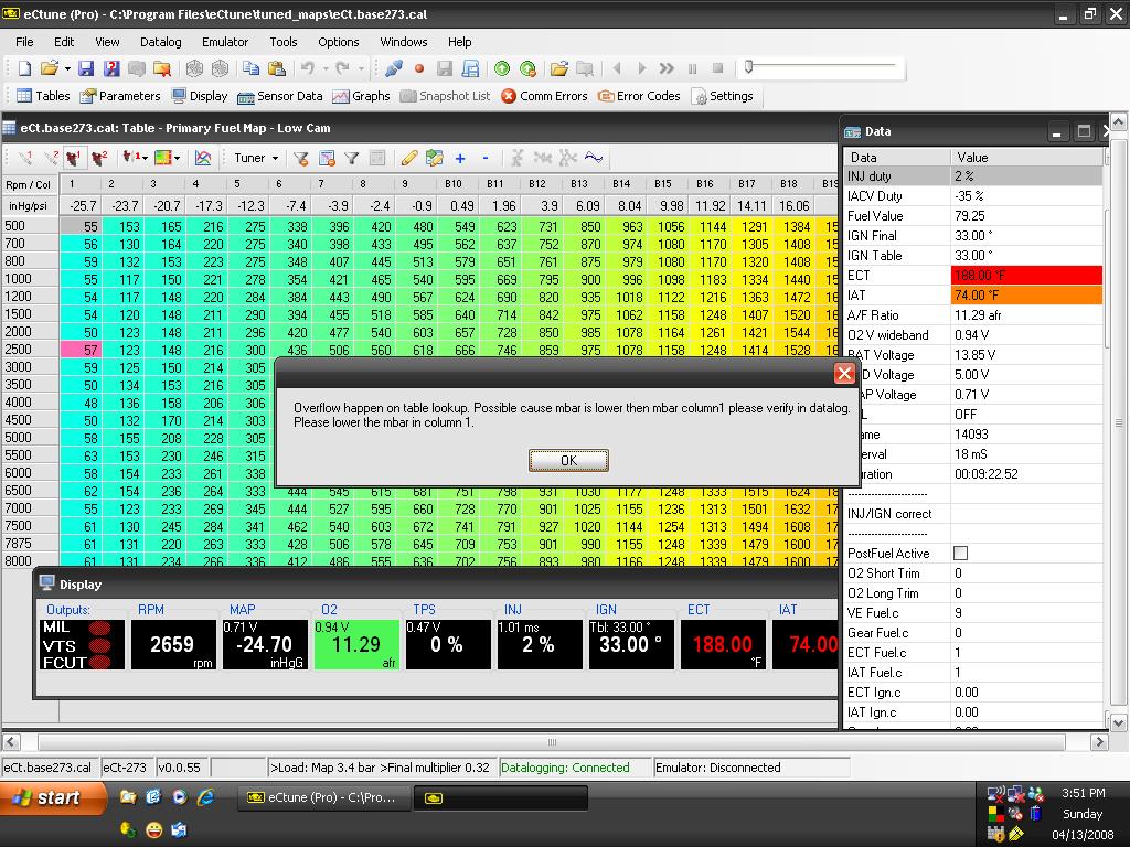

hey Calvin. it may be related to my cal. file but it never seen this before with the previous version of ectune. it happened twice since the new update a couple days ago. it happened once. i rebooted the whole laptop and it happened again. both times it happened with the datalog ecu connected. not logging any data just connected and i was just cruising around watching the display data's. is there something i need to change in my cal. or is it a possible bug?

I believe that's the new warning Calvin installed to warn you to set your mbar lower in your first column. I use 80mbar and I've never seen this. This was on decel correct?

eCt look nice in vista. Lower column 1 is not a bug. Your load(mbar) is lower then column1 and that can cause problems during decel fuelcut

ok will change that. p.s. that is not vista....win xp pro :)
