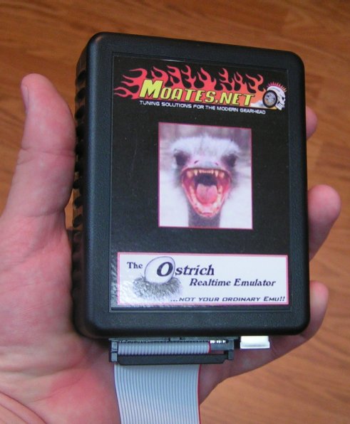

Ostrich version 1
Ostrich version 1
Ostrich v1.jpg (48.9 KiB) Viewed 66635 times

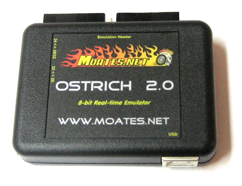

Ostrich version 2
Ostrich version 2
Ostrich v2.jpg (84.09 KiB) Viewed 66635 times
