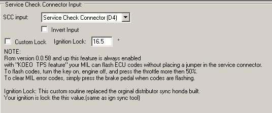

Ok.. Update... E.g. if you put 20 deg at idle and use stock dizzy sync the timing will be 20 deg. SCC only disable ign idle correction. I did some changes KOEO TPS error checking is always enable. You can select any input for SCC routine. When you enable SCC the ignition will lock to 16.5(or custom value) the same value you use with ign sync tool.

ign Sync.JPG (24.37 KiB) Viewed 4079 times
I like the Ignition lock feature here than in the test window. Granted, it's nice to be able to change the IGN value you want with the tool; having it here in the Parameters window makes more sense.
The new feature is perfect and welkom. The ign tool must stay!
both stay. the new one is for customers or if u don't have a laptop with you. Well that never happens to me but
