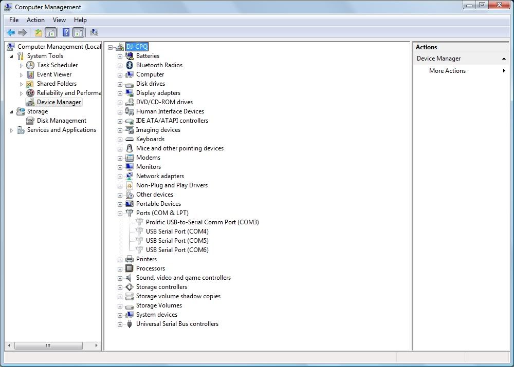

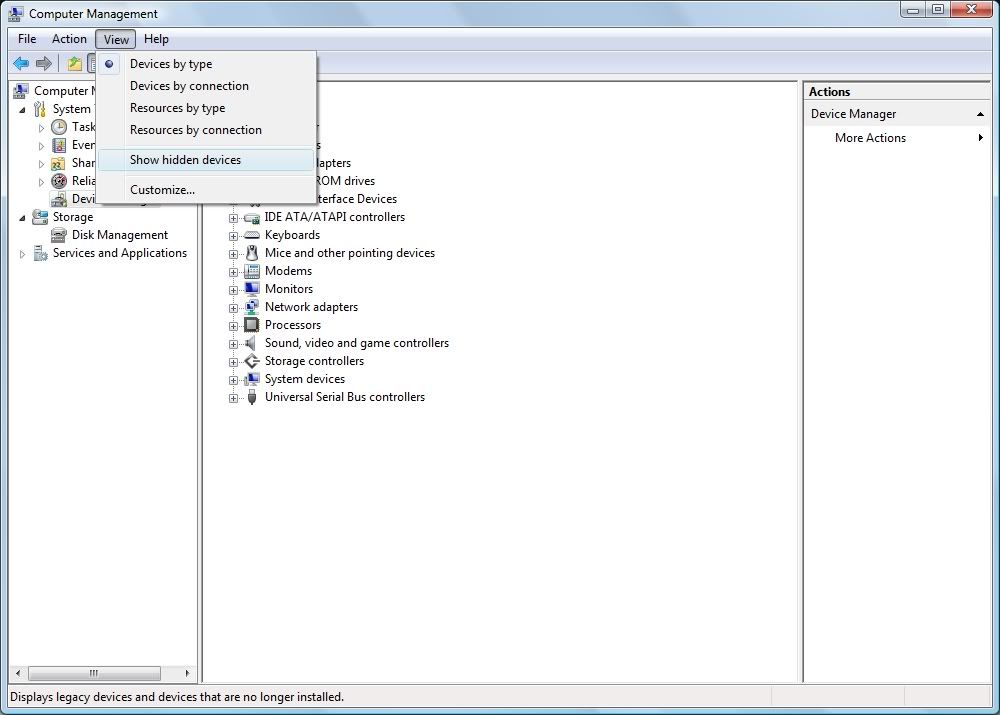

I will post a screenshot from Vista.. it seems that Vista is special and shows you that hardware in the device manager; I removed 17 com ports from the device manager with never plugging them in again.
curios to see
ask and ye shall recieve: Image See, no COM ports shown.... and the menu about to be selected. Image Tada!
Whow! You found something in vista which is better that it was in xp....... Great find!
