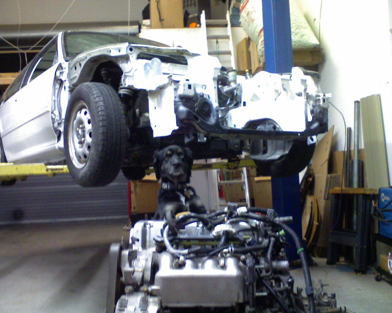

i remember the day that dog kicked his ball under the cabinet and layed down for about 15 min lookin at it...with the multi-colored eyes
