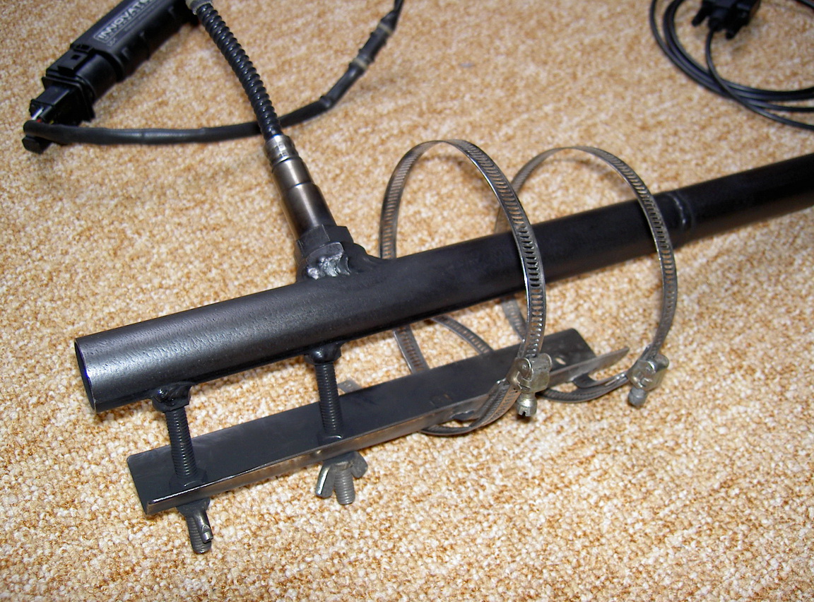

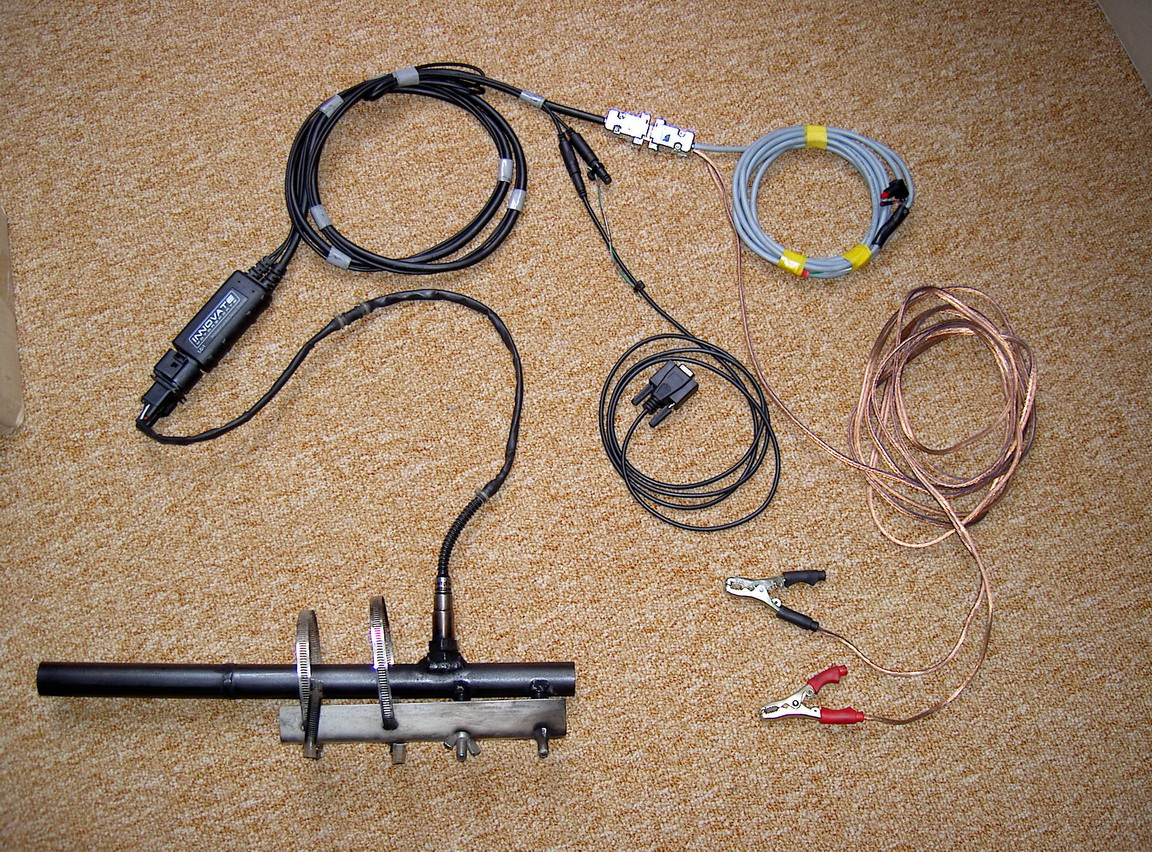

This is my Innovate wideband I use for street and dyno tuning. Who has also a nice setup like this? I dont use the gray cable anymore. That was the old connection for the analog connection to the ecu. But I leave it for the button and checklight.

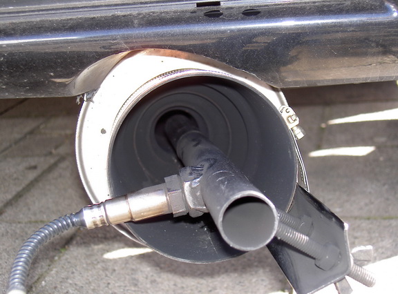

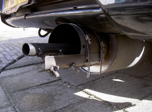

A while ago I made the 1\" pipe a bit longer. (see the welding) After that even idle is no problem anymore. You just have to wait a few seconds before the gases reaches the sensor. On throttle, the gases are traveling so fast you almost have no delay. I can mount this setup in 1 minute without heavy tools or lifting the car. It works like a dream. Perfect for street tuning.

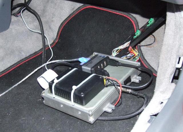

90% of the time I use the sensor in either the original bung, or have the customer install a seperate bung before tuning. I want those fast reaction times and precision. I still have my original 6066 wideband sensor which is now 3 years old or so. The thread does not look pretty, but it still works. I´ll do an accuracy test some time and see if it drifted somehow. Wideband controller is built into the ECU. Now converted to the more recent LSU 4.9 . /Allan
Wideband built in
Wideband built in
mmmm, That hub is a good idea..... I now have 3 USB ports in use on my laptop. Sometimes all those cables makes me crazy.

Why on almost all cars i have noticed a 1AFR difference if i mount the sensor on the exhaust tip, than mounting it on the stock position either with the catalyst on or with a test pipe.
Gaskleppie wrote:mmmm, That hub is a good idea..... I now have 3 USB ports in use on my laptop. Sometimes all those cables makes me crazy.
That's why my car has a 4-port hub in the glove box =)
1 AFR? So 13 is measured like 14??? Whow! You must be measuring the wrong way. I have checked several times and with this setup I have no difference at all. The key point is to make the pipe long enough so it can not measure clean air. I have 1 permanent installed Innovate in my own car, and I have 1 for tuning like on the pictures above. So its very easy to compare them.
Gaskleppie and i had problems with diff afr. After he made the pipe much longer as in pic the problem was gone
