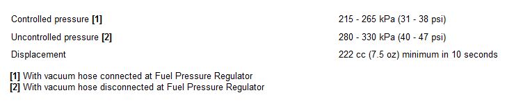

it doesn't necessarily have to hunt or hesitate to have a vac leak, you might have a vac hose that isnt pushed on all the way, or one has a hole in it,and low compression can act like a lean condition. is the motor fresh? how old is it and what is the mileage? what kind of Honda is it in? here is the fuel pressure specs for a 94 delsol with a b16, it should be the same as yours.

jpjackson wrote:it doesn't necessarily have to hunt or hesitate to have a vac leak, you might have a vac hose that isnt pushed on all the way, or one has a hole in it,and low compression can act like a lean condition. is the motor fresh? how old is it and what is the mileage? what kind of Honda is it in? here is the fuel pressure specs for a 94 delsol with a b16, it should be the same as yours.
100k miles on engine. Is a 99 b16a2 fitted in a 98 EJ9 civic which had originally a d14a4 engine. Im going to try get the fuel pressure checked on the weekend. Thanks for the pressure figures.
